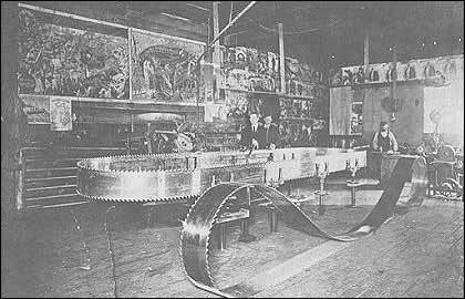

The saw filer was the fourth key man. It was an exacting profession and required a keen eye and ear, for there was much more to filing saws than sharpening teeth. On circular saws, he had to be knowledgeable on the hook, pitch, and shape of the saw-teeth needed to cut different species of wood. Saws, also had to be swaged, and the fillets gummed every third sharpening. A circular saw was not flat, but slightly convex, as the heating of the outer-rim expanded the edge of the saw. The dishing was done by hammering, and this took a keen eye, ear, and experience. He needed to keep several saws sharpened at all times for each of the machines.
View Of Band Saw Filer's Room
(Carl V. Lawhead)
The filing of band saws was a different proposition. The band saw, due to the large number of teeth, necessitated the development of machine filing. Eventually, both band and circular saws were sharpened by machine grinding and touched up by hand. Band saw teeth were both sprint-set and swaged, and as with circular saws, the blades needed the correct hook, pitch, and had to be gummed regularly. The band also had to be uniformly tensioned within the blade itself. Otherwise, there were “fast” or “loose” areas, and that would effect the quality of the lumber. When the saw is in proper tension, the middle portion of the blade is expanded and the use of a straight edge shows that it is curved. The amount of tension varies with the speed and feed of the mill, crown on the band wheels, and structure of the saw blade. The amount carried varies with the individual saw filer. The toothed edge of the blade is always of a smaller circumference than the remainder of the blade. The tension is induced by either hammering or rolling.
The filer's work space was usually within the mill, and in a band mill, almost always in a well-lighted, ventilated room constructed over the head saw. In some instances, the filer's room has been in a room on the main floor of the mill, or a separate building. Band saw stock was supplied in coils and it was the filer's job to cut the blade stock to the correct length, and then bevel each end and silver solder or braze them together. The correct temper had to be maintained, as if it was either too hard or soft, the band would break at that point. Five or six bands were carried in readiness for each head saw and in the course of normal work, each will be used every other day.
